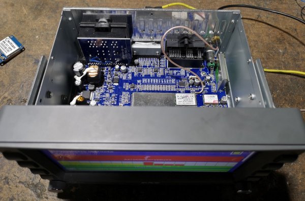

Serg544 70 Опубликовано 24 марта, 2019 (изменено) а!самое интересное...открыл крышку, увиделhttps://www.dropbox.com/s/vinrm4yk71sj3wv/gps%20%D0%BC%D0%BE%D0%B4%D1%83%D0%BB%D1%8C.jpg?dl=0Неужели ничего нельзя сделать, доктор?(с) Изменено 24 марта, 2019 пользователем Serg544 Поделиться сообщением Ссылка на сообщение Поделиться на другие сайты

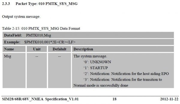

Serg544 70 Опубликовано 4 июля, 2019 ... пока.вопрос не решён с прошивкой.версия 3.4 почему то ни у кого не ловит спутники.хотя показывает что работает,но.спутников нет.Лог пишет, что работает по СОМ2 NMEA 0183 на 57600:21:36:53@000> Raw gps data received, port: COM2:, time: 365704, len: 19, data: \r\n$PMTK010,001*2E\r\n21:36:57@000> Raw gps data received, port: COM2:, time: 369645, len: 19, data: \r\n$PMTK010,001*2E\r\n21:36:57@000> No position info reported.Но каракули после data означают, что навигация ничего не поняла. А вот "правильный" лог с навигатора EXPLAY:00:02:00@000> Raw gps data received, port: COM7:, time: 121300, len: 270, data: $GPGGA,184845.56,0000.0000,N,00000.0000,E,0,0,60.000,0.000,M,0.000,M,0,0*5C\r\n$GPRMC,184845.56,V,0000.0000,N,00000.0000,E,0.000,0.000,010109,0,W,N*2F\r\n$GPVTG,0.000,T,0.000,M,0.000,N,0.000,K,N*2C\r\n$GPGSA,A,1,,,,,,,,,,,,,60.000,60.000,60.000*06\r\n$GPGSV,1,1,1,19,5,0,28*4F\r\n00:02:01@000> Raw gps data received, port: COM7:, time: 122317, len: 243, data: $GPGGA,184846.56,0000.0000,N,00000.0000,E,0,0,60.000,0.000,M,0.000,M,0,0*5F\r\n$GPRMC,184846.56,V,0000.0000,N,00000.0000,E,0.000,0.000,010109,0,W,N*2C\r\n$GPVTG,0.000,T,0.000,M,0.000,N,0.000,K,N*2C\r\n$GPGSA,A,1,,,,,,,,,,,,,60.000,60.000,60.000*06\r\n00:02:02@000> Raw gps data received, port: COM7:, time: 123317, len: 243, data: $GPGGA,184847.56,0000.0000,N,00000.0000,E,0,0,60.000,0.000,M,0.000,M,0,0*5E\r\n$GPRMC,184847.56,V,0000.0000,N,00000.0000,E,0.000,0.000,010109,0,W,N*2D\r\n$GPVTG,0.000,T,0.000,M,0.000,N,0.000,K,N*2C\r\n$GPGSA,A,1,,,,,,,,,,,,,60.000,60.000,60.000*06\r\n00:02:03@000> Raw gps data received, port: COM7:, time: 124307, len: 243, data: $GPGGA,184848.56,0000.0000,N,00000.0000,E,0,0,60.000,0.000,M,0.000,M,0,0*51\r\n$GPRMC,184848.56,V,0000.0000,N,00000.0000,E,0.000,0.000,010109,0,W,N*22\r\n$GPVTG,0.000,T,0.000,M,0.000,N,0.000,K,N*2C\r\n$GPGSA,A,1,,,,,,,,,,,,,60.000,60.000,60.000*06\r\n00:02:04@000> Raw gps data received, port: COM7:, time: 125297, len: 243, data: $GPGGA,184849.56,0000.0000,N,00000.0000,E,0,0,60.000,0.000,M,0.000,M,0,0*50\r\n$GPRMC,184849.56,V,0000.0000,N,00000.0000,E,0.000,0.000,010109,0,W,N*23\r\n$GPVTG,0.000,T,0.000,M,0.000,N,0.000,K,N*2C\r\n$GPGSA,A,1,,,,,,,,,,,,,60.000,60.000,60.000*06\r\n Кроме того, на ШГУ пробовал ПРОГород. Не ловит. В интерфейсе ПРОГород удобно "на ходу" менять СОМ и битрейт, но от удобства лучше не стало.При этом и Навител и ПРОГород на EXPLAY работаю нормально. Про PortTool не пишу, т.к. по сути он адекватно сработал на EXPLAY, а на ШГУ ругался failed. По итогу, добрые люди посоветовали прикупить внешний GSM-модуль и будет счастье.Закажу на днях. Дальше видно будет. Поделиться сообщением Ссылка на сообщение Поделиться на другие сайты

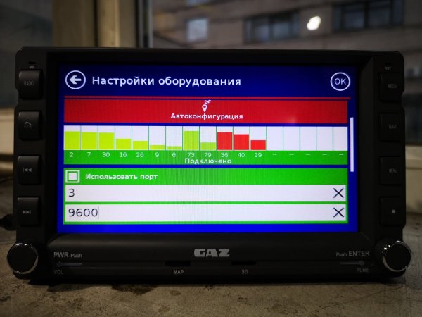

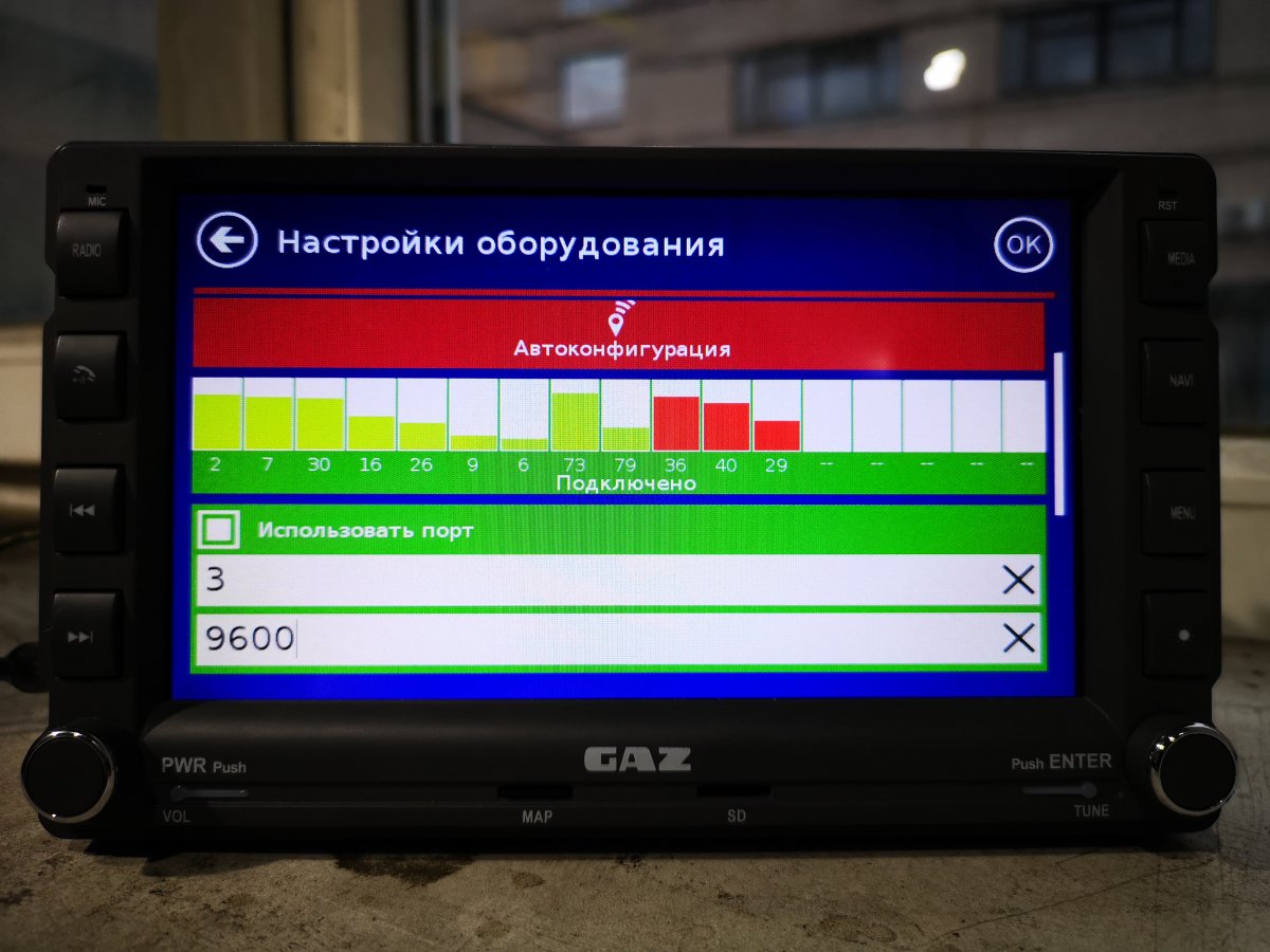

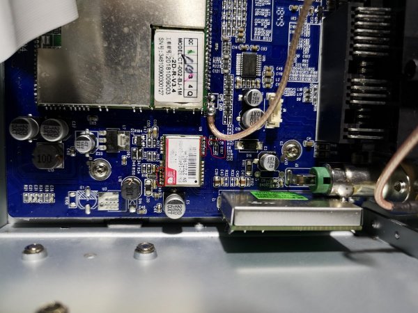

JIekceu 0 Опубликовано 21 ноября, 2019 (изменено) В 15.07.2019 в 19:17, Crady сказал: так он и работает и без всяких танцев,работает на физическом уровне.только вот его "забыли" прописать в прогу Штатный GPS-модуль не работает, поскольку висит в вечной загрузке, о чем и говорят логи с него. Припаял на свободное место модуль SIM28 и подключил к нему антенну, переставив резистор на плате - все заработало. COM3, 9600. Вместо этого модуля можно повесить на проводах любой другой. Модуль со встроенной антенной BN-357 показал немного лучшую чувствительность, чем SIM28 с выносной антенной на штатном разъеме. Изменено 21 ноября, 2019 пользователем JIekceu Поделиться сообщением Ссылка на сообщение Поделиться на другие сайты

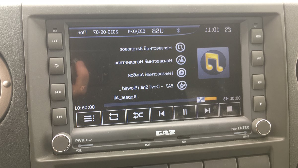

gapon 12 Опубликовано 7 сентября, 2020 Народ привет. Что случилось и как исправить? Перезагрузка не помогает ни сбрасыванием клеммы ни кнопкой reset 1 Поделиться сообщением Ссылка на сообщение Поделиться на другие сайты
lostmedia 354 Опубликовано 7 сентября, 2020 @gapon , попробуй поискать в меню ,,зеркальное изображение". Поделиться сообщением Ссылка на сообщение Поделиться на другие сайты
gapon 12 Опубликовано 7 сентября, 2020 3 часа назад, lostmedia сказал: @gapon , попробуй поискать в меню ,,зеркальное изображение". Да вот не могу найти :( Поделиться сообщением Ссылка на сообщение Поделиться на другие сайты
